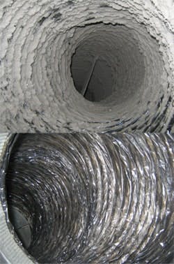

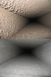

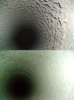

As air is drawn through an HVAC system, particulates gradually begin to collect on the interior of the ductwork, fan, fan housing, coils and other parts in contact with the air stream. As time goes on, the particles can coat the surfaces to a thickness of three inches or more. Although contaminant buildup usually isn’t more than 0.5 inches deep, sometimes it can be several inches. A two-inch buildup on the bottom of a 12 inch x 12 inch duct makes it a 10 inch x 12 inch duct. This narrowing of the flow area produces more resistance to air going through, adding to the energy bill. A Japanese study in the 1980s, however, found that when the contaminant coating thickness reac hes 0.03 inches, the particulates start to peel off and reenter the air stream.
HVAC systems get dirty over time, but at variable rates. Contaminant accumulation rates and peel-off rates are determined by a variety of factors, including duct size, air speed, air volume, particulate load in the air and particulate size. Some systems accumulate large amounts of debris and some reach a point of near equilibrium, where the rate of accumulation is only slightly higher than the rate of peel-off.

The cleaning process
Duct cleaning technology has been refined over the years. In the 1980s, the National Air Duct Cleaners Association (NADCA) promulgated industry standards to promote greater professionalism. Today, most reputable duct-cleaning firms are certified NADCA members.
Duct cleaning is usually done during off hours, when operations are shut down, so cleaning contractors work nights and weekends. Duct-cleaning equipment varies by company and even by region, but there are two basic technologies: contact cleaning and negative-air cleaning. With either method, each part of the HVAC system gets cleaned, including the registers, coils, air hander and ductwork.
Contact cleaning is the old-school method. The ductwork is hand-vacuumed. If the ducts are large enough, a technician crawls the interior. If not, the ducts are cleaned by cutting access holes every 15 feet or so, reaching in and vacuuming. Contact cleaning is the most thorough method but, because it can be more labor intensive (and thus more costly), it’s not used very often. However, even on some modern jobs, part of the work might require contact cleaning.
Negative-air-cleaning technology has been developed during the last 20 years. It involves a large vacuum (known as a negative-air machine) attached to a duct opening to produce a powerful draw of air through a section of ductwork. A variety of tools can be run through the duct while the vacuum is operating. Hoses can blast air and augers (long cables with a spinning brush on the end) can agitate the particulate into the air stream for the negative-air machine to collect.
Regardless of approach, industry best practices say that it’s insufficient simply to connect a strong vacuum up to the duct. Some kind of contact agitation, such as air blasting or mechanical brushing, is required on the interior duct surfaces to remove particulates more effectively. NADCA standards also dictate that either method must use vacuum devices equipped with high efficiency particulate air (HEPA) filters that catch particles as small as 0.3 microns.
