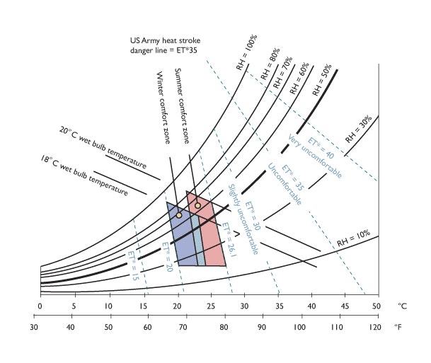

Probably the most common index of thermal comfort is the “new” Effective Temperature (ET*) developed by Gagge and others in 1971. This index is based on human physiological regulatory response that establishes environmental conditions equivalent to a Celsius air temperature when relative humidity is 50%. Lines of constant ET* have varying slopes when plotted on a psychrometric chart (see Figure 2). For purposes of comparison, a standard effective temperature (SET*) adopts a set of parameters. These are the use of operative temperature to accommodate radiation effects, clothing insulation value of 0.6 clo (a measure of the ability of clothing to keep you warm), an activity (metabolic rate) of one met, air movement less than 0.2 m/s and an exposure time of one hour.
Thermal comfort zone
Individual responses to the thermal environment vary. There’s no universal ET* that everyone perceives as comfortable, which explains why thermal comfort is defined as a range of ET* values bracketing the comfort zone.
Two such zones — for winter and for summer — are defined (see Figure 2). These zones account for peoples’ ability to adapt to seasonal changes by choice of clothing. Figure 2 also indicates various degrees of discomfort as ET* values.

Figure 2. Standard effective temperature (SET*) and ASHRAE comfort zones (after information from ASHRAE fundamentals handbooks).
