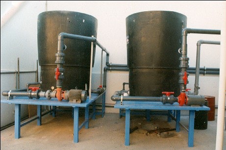

Two engineered plastic cooling towers installed at an industrial facility. The tower on the left was installed 25 years before the tower on the right and shows no damage from corrosion.
