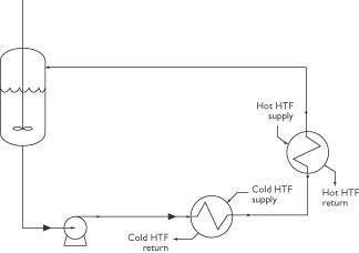

Another method uses a circulating loop that passes the circulating process fluid through heat exchangers in series (see Figure 2) with one heating the fluid and the other cooling it. This solution is more mechanically complex than the first approach, but offers some advantage in that the heat exchangers may be designed without vessel geometry or jacket area acting as design limitations.
Figure 2. This approach uses a circulating loop that passes the process fluid through series heat exchangers.
