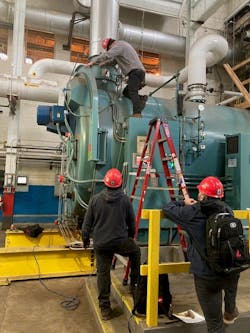

A well operating and reliable boiler requires scheduled maintenance performed by qualified in-house personnel and/or boiler service agency (see Figure 3). Proper boiler maintenance encompasses both fire-side and water-side consideration.
Sound water-side maintenance begins with good feedwater quality to prevent corrosion and scale buildup on surfaces. There are recommended water quality values which can be provided by a water quality expert that addresses suspended and total dissolved solids (TDS) levels, dissolved oxygen, hardness, pH, alkalinity, and others. Routine boiler “blowdown” is normally required to maintain acceptable solids levels of boiler water within certain specified limits.
Boilers also require periodic fire-side inspection and maintenance to ensure boiler surfaces are kept clean, free from soot and scale, and identification of possible leakage. These inspections are typically performed semi-annually or on an annual basis. Scale buildup, shown in Figure 4, can lead to poor heat transfer and lower efficiencies. Even 1/16” of scale can account for 4% to 6% of total fuel use.
Boiler safety devicies, pumps, boiler controls, and other boiler equipment also require periodic inspection and maintenance where and when needed. Other boiler system devices such as steam traps can be a source of significant steam loss and inefficiency. Therefore, system devices such as steam traps should be inspected regularly.
