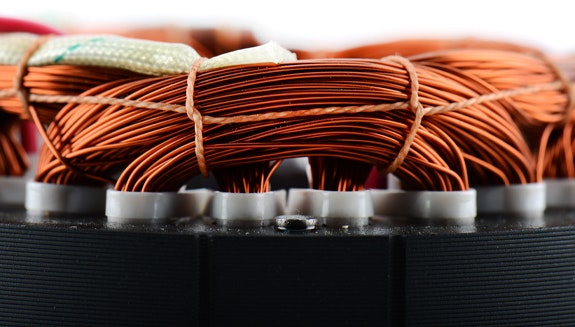

AR100 concisely describes the requirements for a good practice rewind in just two pages, beginning with inspection of the windings (see Figure 2) and rotor squirrel cages. It’s important to remember that the rotor is an electrical component—the rotating secondary of a transformer, with the stator being the primary. Failure to detect defective rotor bars or end rings (see Figure 3) could reduce output torque or cause vibration.
Winding data. Exact duplication of the original winding characteristics is crucial to maintaining motor performance and energy efficiency. As a good practice and preventive measure, AR100 therefore recommends recording and checking the accuracy of the “as-found” winding data (see Figure 4) before replacing the old winding. It also recommends that in the new winding the average length of the coil extensions should not increase, and that the cross-sectional area of the conductors should be the same (or increased, if possible). Following these good practices will maintain or reduce winding resistance and losses, thereby maintaining or increasing winding life and energy efficiency.
Stator core testing. Stator cores consist of a stack of thin steel discs called laminations. Each lamination is insulated on both sides and has a notched circular opening that forms the stator bore and slots to hold the winding. If electrical shorts develop between the laminations, circulating currents will increase stator heating and losses.
AR100 provides good practices for core inspection and testing, with a focus on detecting core degradation such as shorted laminations. For example, it prescribes loop or core testing (see Figure 5) to magnetize the stator before and after winding removal, investigation of any increase in core losses, and repair or replacement of damaged laminations. This helps identify a faulty core before repair, not after—or worse, after the customer places the repaired machine in service.
Winding removal. How to remove (strip) the old windings from the stator core without damaging the laminations receives special attention in AR100. A specific good practice that it provides is first to thermally degrade the winding insulation in a temperature-controlled oven (see Figure 6), while monitoring the temperature of the part, e.g., the stator. This makes it easier to remove the old windings without damaging the stator core.
Insulation system. Another AR100 good practice is to ensure that the insulation system of the new winding is equal to or better than the original and uses compatible components. The “better than” option is normally achievable since service centers typically use class H (180°C) systems for random windings (see Figure 7) and class F (155°C) systems for form coil windings. Most motor manufacturers use either class F (155°C) or B (130°C) random windings and class B (130°C) form coil windings.
Winding impregnation. AR100 also stresses good practices for winding impregnation (see Figure 8). Key points include preheating the stator winding; using varnish/resin with an adequate thermal rating; and ensuring that the treatment is both compatible with the insulation system and suitable for the application environment. Although every part of the rewind process is important, the cured varnish/resin literally is the “tie that binds” the winding components together. It also ensures good heat transfer from the winding to the stator core and cooling air.
