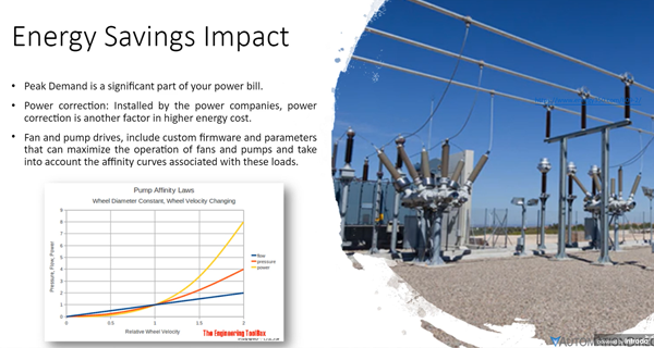

PS: Why should I use a drive on a pump or a fan?
JP: Drives are very useful on pumps and fans due to the pump and fan efficiency curves. Lowering the current and total power does save you money when using these with fan and pumps. There are definitely some algorithms that are built into these drives that allows you to definitely increase your efficiencies.
