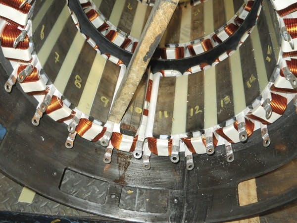

The concentrated windings on the salient stator poles (Figure 13) have much shorter end turn lengths than conventional induction motor windings. This reduces the average turn length and, consequently, the winding’s resistive power losses. The rotor poles (Figure 14) do not have any conductors or permanent magnets; and the large air spaces between poles reduce the rotor inertia, sometimes by more than 50% compared with a conventional squirrel-cage rotor. That, in turn, increases the dynamic response to changes in speed.
