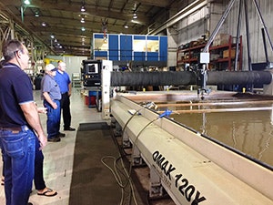

Water jets and CNC machines are not usually found in motor-repair facilities, but they are invaluable when specialty parts are required.
A state-of-the-art motor repair facility will have its own complete machine shop with skilled machinists, eliminating the need to outsource machine work. Your motor shop should be capable of repairing your entire machine, including pumps, gearboxes, fans and blowers. Some progressive shops will even have specialized equipment, such as 3D printers, to facilitate the manufacture of parts that may be obsolete or unavailable. Water jets and CNC machines are not usually found in motor-repair facilities, but they are invaluable when specialty parts are required. Having a well-equipped machine shop on the premises saves time, ensures quality, and helps eliminate the risk of miscommunication.
