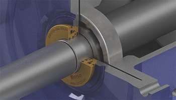

1660318653523 Cutawayinpump
How to protect bearings and extend motor life
June 17, 2019
Compound labyrinth seals prevent contamination of bearings and bearing lubricants.

The typical bearing bracket sealing method on an electric motor is a small gap, or clearance, between the bearing bracket and the shaft’s outside diameter. Sometimes, a nitrile “flinger” is placed on the shaft. This is added to literally fling contaminants off the shaft before they enter the bearing cavity. In most applications, these sealing methods are ineffective.
Eliminating lubricant contamination

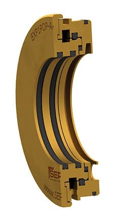

The best equipment to protect the motor bearing lubricant from liquid or particulate contamination is a noncontact, compound labyrinth bearing isolator. These bearing isolators are designed to keep the majority of contaminants out. Should contaminants enter the interior, the design uses specific clearances, gap changes, and direction changes to control them. The technology directs the contaminants away from the bearing cavity using centrifugal force and gravity. It expels the contaminants outside the seal and away from the bearing. This prevents contamination of the bearing lubricant and greatly extends the life of the lubricant and the bearing.

These bearing isolators also keep the bearing lubricant within the bearing cavity, where it belongs. As a result, the lubricant can do its job of keeping the bearing components apart, preventing premature failure. Less contact of bearing components means less wear, which means extended bearing life. Also, this compound labyrinth seal should never need replacement. This provides even greater cost savings.
By increasing the bearing’s life, the electric motor’s life can easily be extended. In many cases, this extension can be a doubling or greater. All of this can be achieved by simply installing proper bearing protection in the form of a nonwearing, noncontact, compound labyrinth bearing seal.
