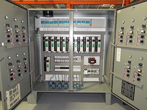

Figure 1. This motor control center is part of a complete package, saving costs to run all of the pumps/motors at a reclamati
