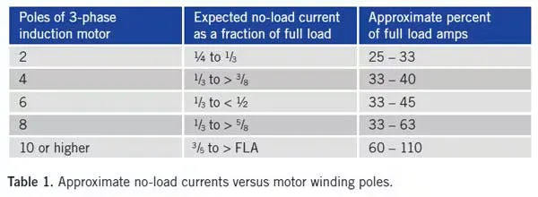

One situation in which higher-than-expected no-load current can occur is with reconditioned motors. Although some motors with no-load currents above or below the guidelines shown in Table 1 may still be satisfactory, motors with no-load current outside of these ranges warrant further analysis.
When no-load current is high or low, consider the actual test operating voltage versus the motor’s rated voltage. If the applied voltage is not within 10% of the motor’s rated voltage, then the no-load current can be much higher or lower than expected. For example, test-operating a motor rated 200 volts on a 240-volt supply system is almost certain to result in relatively high no-load current.
