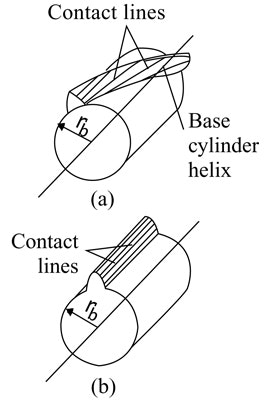

Figure 4. Helical gear tooth pattern versus straight spur gear tooth pattern.

  • Spur gears and helical gears work identically to transfer power from one gear to another. However, the tooth of a helical gear is not parallel to the gear axis; it is set at an angle (Figure 4). Since the surface over which the tooth is made is cylindrical, the tooth takes the shape of a helix. As the gear tooth is diagonally positioned, it is effectively larger when compared to a straight cut spur gear. This, along with an inherent higher gear tooth contact ratio, results in greater load (torque) carrying capability. In addition, as a helical gear meshes with another helical gear, there is a gradual engagement/disengagement of the teeth as they rotate. The contact line of the meshing teeth progresses diagonally across the face from the tip at one end to the root of the other, reducing vibration and noise
