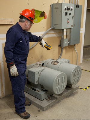

Thermal
Speaking of safety, when dealing with operational equipment, start with a thermal inspection (Figure 2). You will still need to wear PPE — reference NFPA 70E for the specific gear required for non-contact inspections — but it’s both less dangerous to be several feet away and the thermal picture view shows you at a glance what kind of heat signature the system is giving off (Figure 3). Is it normal? Compare to a similar system or to a previous image to make that determination. Differences in temperature will help you to build a quick list of what to measure first with your other measurement tools.
Figure 3. The thermal picture view shows you at a glance what kind of heat signature the system is giving off.
High temperatures in and of themselves don’t necessarily mean anything, but a component with a higher temperature than that of similar components, or a rise in temperature, are good indicators that something is amiss. For example, a coupling that is running warm could indicate misalignment. A motor’s heat signature will tell you a lot about its quality and condition. If a motor is overheating, the windings will rapidly deteriorate. In fact, every increase of 10 °C on a motor’s windings above its designed operating temperature cuts the life of its windings’ insulation by 50%, even if the overheating is only temporary.
On the electrical side, check for phase imbalance, bad connections, and abnormal heating on the electrical supply. On the mechanical side, infrared can often detect shaft bearings issues; they tend to run hot for several days before fully failing. Motor case temperature can also be a good measurement point. However, to correctly interpret motor case temperature, you must first know what the norm is. Make it a habit to take temperature measurements of your motors when they are running well, so you have a baseline for comparison.

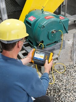

Vibration
The majority of mechanical failures with rotating machines come from four faults: imbalance, misalignment, roller bearings, and looseness. Imbalance and misalignment can both lead to roller bearing wear and early failure.
What not everyone knows is that vibration is one of the earliest indicators of machine health (Figure 4). Yes, thermal imaging will show you when a problem has gotten bad enough to cause overheating. Vibration, however, is far more sensitive and can detect an issue much earlier than thermal inspection, long before components are damaged. These days, people are also thinking about machine efficiency. When machinery is misaligned, friction starts to eat up not just the hardware but the electrical supply, creating more than one reason to take a reading every so often, which can be demonstrated with the P-F curve (Figure 5).
Figure 5. The farther along the path, the greater the degree of energy overconsumption, as the unit compensates for the friction-based issue.
When mechanical faults arise, instead of just replacing bearings, take the extra time to determine the root cause of the fault. Once the machine is properly aligned and the shafts balanced, the bearings will have much less strain on them and will last for years.
Handheld vibration meters and testers make all of this much easier and quicker than it used to be. The handheld tools carry a database of good/bad readings, dynamically compare vibration signals, and can even give you a diagnosis on the spot, depending on the sophistication of the tool. It used to be that only predictive maintenance/reliability specialists did vibration analysis. Now a broader range of technicians can carry a vibration meter into the field with them for good/bad spot checks and experienced senior technicians can easily “train up” to using a handheld vibration diagnostic meter for follow-up evaluation. That significantly enhances a maintenance team’s understanding of the overall machine health and bearing condition; and, once again, the data can be shared and stored.

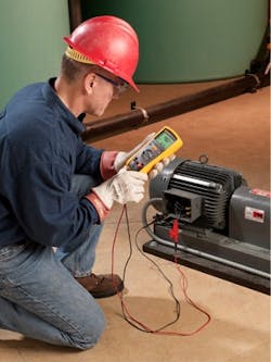

Insulation testing
Figure 6. Insulation problems on motors and drives are usually caused by excessive heat, improper installation, environmental contamination, mechanical stress, or age.
Insulation problems on motors and drives are usually caused by excessive heat, improper installation, environmental contamination, mechanical stress, or age (Figure 6). Insulation testing can easily be combined with regular motor maintenance to identify degradation before failure, and during installation procedures to verify system safety and performance. When troubleshooting, insulation resistance testing can be the missing link that enables you to get a motor back into operation the easy way, by simply replacing a cable.
An insulation multimeter combines the function of insulation resistance testing with all of the most common digital multimeter functions. For a technician with a lot of motors on his beat, this makes it the go-to tool for performing most of the tests needed to troubleshoot and maintain motors. When a motor is having problems, check the supply voltage and then use the Ohm function to measure the motor winding resistance phase to phase. Next use the insulation resistance function of the meter to measure the line and load conductors to ground and motor windings to ground.
By measuring the insulation resistance of motor windings, you can detect deterioration caused by heat, age, corrosion, dirt, moisture, and excessive vibration before the motor fails. Because insulation resistance varies with temperature and humidity, you may need to take several resistance measurements over a period of time to get an accurate result. Periodic insulation resistance measurements will tell you how healthy your motors are and when to replace or rewind them.
