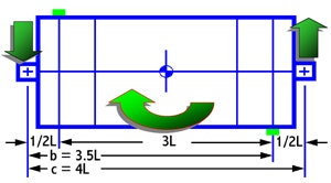

Figure 1 represents a symmetrically separated, two-plane rotor. If we ignore the rotor’s weight, we realize that the bearings react only to the imbalance. Equations 2 and 3 represent the forces acting on the right and left bearing, respectively.
Fr = (a-b)McRcω²/c           (Equation 2)
Fl = -(a-b)McRcω²/c = -Fr     (Equation 3)
McRc is the couple unbalance and, in this case, a = L, b = 3L, c = 4L. This implies that:
Fr = (L-3L)McRcω²/ 4L = -0.5 McRcω² (Equation 4)
Fl = -Fr = +0.5McRcω²               (Equation 5)
If we try to counterbalance the original moment through field balancing at two planes, again, symmetrically separated, but closer to the bearings, we have the situation depicted in Figure 2.
Equations 2 and 3 still apply, but with reversed signs. The additional compensating unbalance induces its own load on each bearing.
Fr = (3.5L-0.5L)mcrcω²/4L = 0.75 mcrcω² (Equation 6)
Fl = -Fr = -0.75 mcrcω²                  (Equation 7)
This only isolates one couple unbalance at a time. If they’re added by superposition, the forces on the bearings can cancel each other (Figure 3), if McRc = 1.5 mcrc.
