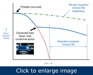

Dynamic or in-service testing, is performed while the motor is operating within its normal system or environment. Data collection with dynamic motor testers is safe, fast, and non-intrusive. Dynamic testing provides information regarding power quality and conditions such as voltage levels, unbalances, and distortion. A small amount of voltage unbalance coupled with minor harmonic voltage distortion may result in a NEMA (National Electrical Manufacturers’ Association) de-rating that will not be seen with simple multimeters and Amp probes. Current levels and current unbalances also affect motor performance, and monitoring them is essential when trending motor health.
Figure 1. The ability to acquire and define adverse impacts such as torque provides maintenance professionals the means to separate the mechanical from the electrical issues, improve decision-making concerning repair or replacement, and otherwise extend the service life of the motor.

Besides electrical issues with motors that the technology can monitor, many mechanical issues with a motor and its system are also discernable with data that dynamic analyzers can collect. Torque and current spectra have proven to be highly useful in determining mechanical issues, including bearing faults, looseness (vibration or misalignment), and eccentricity. Again, considering a motor is part of a motor/machine system with three aspects (power source, load source, and the motor itself), a good dynamic analyzer provides relevant condition information about all three. Many motor problems are created by adverse or mismatched loads, or by poor supply power. Without a means of analyzing data from monitoring across a motor system, the true root cause of motor failure often goes undetected. The ability to acquire and define such adverse impacts as torque provides a maintenance professional the means to separate the mechanical from the electrical issues, improve decision-making concerning repair or replacement, and otherwise extend the service life of the motor (Figure 1).
Dynamic testing provides health information about motor systems across power source, motor, and load source.  It monitors power quality and conditions such as voltage levels, unbalances, and distortion. Another challenge with electric motors is tracking the condition of their rotors.
Today’s dynamic motor analyzers help predict rotor bar failures or potential failures if the load is relatively steady. A pump, fan, or blower operating at a steady frequency will show very clear rotor bar signatures that make rotor fault diagnoses easier than ever before. During normal operation, a motor’s rotor is stressed by its load. Torque waveform analysis provides a picture of those stresses and, when they reach levels out of spec for the motor, can be an indicator of a number of mechanical problems. Cavitations and belt flapping, for example, are easily seen in a torque waveform signature. Motor analyzer manufacturers continue to improve upon the ability of test equipment to discern other mechanical motor system issues earlier and with greater accuracy.
