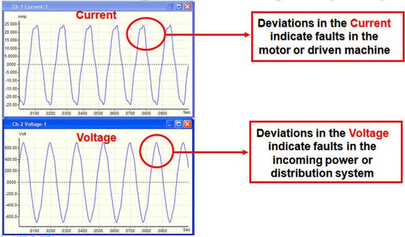

Today there might be several generating stations sending power to the grid supplying your facility. The power might travel through many different transmission paths and across several municipalities or distribution districts before reaching the plant. There are currently 50 different power quality standards in the United States, one for each state, and yet power supplies aren’t restricted to state boundaries. The bottom line is that the quality of the power used to drive a plant's multiple machine motors can vary.
Some plants routinely monitor incoming power but routinely don’t check the quality of the power delivered to the motor at the motor control center (MCC). A 2% voltage unbalance in the motor control center can generate as much as a 20% current unbalance within the motor, and this unbalance produces circulating currents within the motor. The circulating currents, in turn, result in excessive heat generation within the winding and eventual insulation breakdown, leading to a catastrophic failure of the motor winding.
Figure 2. Deviations from the incoming voltage are reflected in the motor current. However, if a fault in the motor system is caused by the motor or the driven machine, these fault frequencies are in the current spectrum, but not in the voltage spectrum.

ESA uses algorithms to identify both electrical and mechanical faults in the motor and mechanical faults in the driven machine. In addition to finding mechanical faults, ESA performs a survey of the motor systems power quality. Like machine vibration analysis, ESA performs a Fast Fourier Transform on the input voltage and current waveforms of the motor to determine the content of their respective frequencies. If the spectral peak is in the current waveform only, the fault is in the motor or the driven machine. However, if it’s in both the voltage and current spectrums, the fault is traced to the incoming power. ESA can positively identify stator faults, such as loose windings or a loose stator iron, as well as motor assembly faults that cause unbalanced magnetic fields, including distortions of the stator magnetic field, or rotors that aren’t centered in the magnetic field. ESA also identifies other mechanical problems in the motor such as the condition of the rolling element bearing or the balance or alignment of the rotor system. In addition, faults in the coupling system, such as loose or cracked belts or gear problems, also can be identified automatically using ESA.
The key to signature analysis is identifying frequency content of the input signal and correlating these frequencies to the operating condition and design of the machine.
ESA uses the change in the air gap between the rotor and the stator or changes in current to indicate faults in the motor system. If either the air gap inside the motor or the load on the motor changes, the motor current will change. Periodic events, such as vane passing frequency, causes the motor current to modulate at the frequency of the event.
