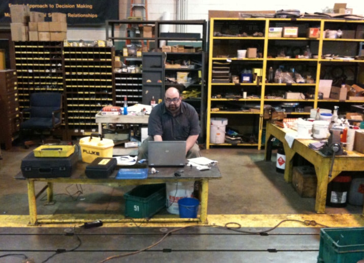

Figure 1. The 150-hp motor being prepared for testing on a 400-hp dynamometer.
Figure 2. Collecting dynamometer and instrumentation data using Bluetooth technology.
In particular, the reference to 680° F and 750° F for high-grade core steel in burnout is related to the core temperature of the machine, not the oven temperature. The cited studies documented that the core temperature is an average of 120° F higher than the oven temperature. Therefore, setting the temperatures at 650° F and 750° F exceed the acceptable limits as did the practice of loading more than one stator at a time in an oven.
Of concern here is the relationship of repair outcome to the IEEE Standard 1068-20103, traditional repair practices, observations and precision motor repair (PMR) practices. The three electric motors used in these examples were evaluated for efficiency using IEEE Standard 112-20044 Method B (Segregated Losses). The changes applied to losses and evaluated efficiency are based upon allowable limits by standards and observed changes to machines. The various effects can be related to greenhouse gas emissions.
Evaluated machines
The three machines in question were 150 hp, 3 ph, 460 VAC, 167 A, 1,780 rpm that were measured for efficiency at load points 25%, 50%, 75%, 100% and 125% in accordance with IEEE Standard 112 Method B (Figures 1 and 2).
