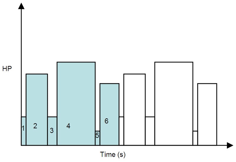

Figure 4. The demands on a motor can be variable, as illustrated by this representation of horsepower as a function of time.
Duty cycle Continuous duty implies that the load is essentially constant and might last for an indefinite time, usually many years. Intermittent duty means a repeating cycle of the motor being loaded for a period of time and then a period of unload or motor shutdown. In a varying duty cycle, the motor is subjected to a wide variety of loads (Figure 4).
Both peak and root-mean-square (RMS) horsepower are important variables. Use peak for selecting the motor torque, and RMS horsepower for selecting from a heating standpoint. RMS horsepower is the RMS average horsepower over the cycle. It’s calculated by making up a table (Table 2) with the peak horsepower and time for each step in the cycle.

Table 2. Example data for calculating RMS horsepower
The right-hand column shows the square of the applied horsepower multiplied by the duration of that part of the cycle. Sum that column and the time column to learn that, for this example application, total time = 190 seconds and the sum of the individual values of hp2t = 394,000. These values suggest that:
RMS hp = sqrt(hp2t /t)
       = sqrt(394,000/190)
       = sqrt(2,074)
       = 45.5 hp RMS
This implies selecting a motor of about 50 hp with a breakdown torque sufficient for the highest torque demand.
