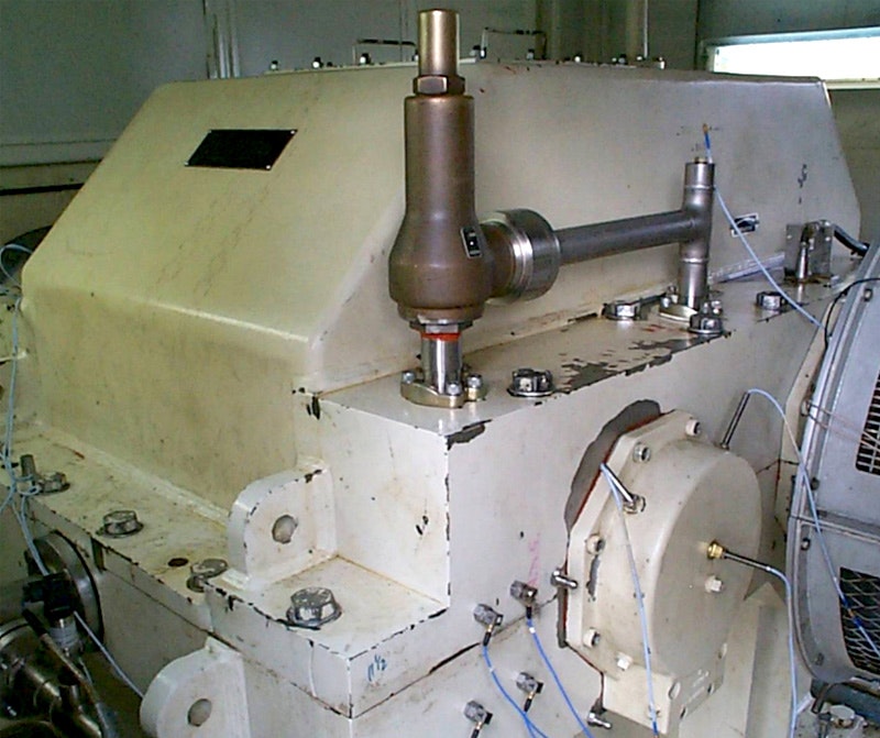

Figure 1. The serious malfunction, which consisted of broken pinion teeth in the gearbox, took the entire system out of service. The root cause of the failures was a mystery to both the unit’s owner and the gearbox OEM.
A 37-MW electrical power generation system driven by an aeroderivative gas turbine (Figure 1) suffered a puzzling failure in its parallel-shaft gearbox (Figure 2). After only several thousand hours of operation under typical service conditions, the teeth broke on the pinion of a double helical gear set (Figures 3 and 4).
The original equipment manufacturer (OEM) asked us to uncover the underlying cause of the failed gear teeth. Previous studies of this matter proposed gear mesh misalignment as the root cause of the failure. The basis for this conclusion was founded primarily on bluing patterns observed on the pinion’s turbine-end helix.
Because the gear tooth failures were attributed to misalignment, the OEM had begun to redesign the gear tooth profile on the replacement gear to better tolerate misalignment. Nonetheless, the OEM suspected that the gear mesh misalignment theory didn’t explain the gear tooth failures completely. At the time, however, a better explanation wasn’t apparent.
Figure 2. The drivetrain’s gearbox was instrumented with accelerometers, velocity transducers and proximity probes to record the response during the routine operating conditions.

We performed a comprehensive on-site evaluation of the drivetrain to capture data that potentially could suggest a better explanation for the failures. This mechanical testing included operating forced response and impact modal testing, vibration monitoring during partial and transient load events, and measuring critical dimensions in the gearbox and shaft position as load and temperature varied. Accelerometers, velocity transducers and a multi-channel data acquisition system captured structural and rotor vibration measurements. Radial proximity probes at each end of both gearbox shafts and an axial proximity probe measured movement of the input (pinion) shaft (Figure 2).

The source of the external force, and cause of the failures, was thermal growth in the high-speed rotor system (pinion and the power turbine). To be transmitted to the pinion, such an external axial force also had to have passed through the disk-pack type mechanical coupling connecting the turbine and gearbox.
[pullquote]
In general, disk-pack couplings are flexible in the axial direction. However, test data showed that drivetrain axial thermal growth exceeded the maximum axial travel that this particular flexible coupling could tolerate.
The drivetrain’s axial growth pushed on the bull gear rotor thrust bearing, which then transmitted the unbalanced axial load to the gear teeth. The turbine-end helix carried significantly more load than did the alternator-end helix, and this load imbalance led to pinion geartooth failures well within the equipment’s expected operating life.
A modification of the coupling to include additional axial clearance corrected the machinery problem. The coupling then accommodated thermal growth between the power turbine and gearbox pinion at the operating conditions of the high-speed rotor system. Gear-mesh misalignment wasn’t the primary factor causing gear tooth failures, which suggested that gear tooth profile modifications the OEM was devising at a cost of $300,000 weren’t necessary, and might even be harmful.
The additional testing and analysis identified the root cause of the equipment malfunction, saved the OEM money and potentially prevented additional costly gearbox failures.
