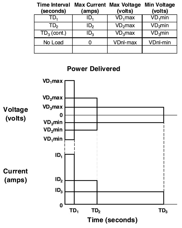

Power delivered
Different types of lift trucks are designed for different applications and capabilities, and varying amounts of power are required to accomplish these tasks. It takes more power to lift 4,000 pounds to 30 feet than it does to drive with no load on a level floor, and hydrogen fuel cells must provide the same amount of power as lead-acid batteries to accomplish these tasks. Specifying the current and voltage delivery requirements of the lift truck at various time durations ensures the lift truck receives the power from a hydrogen fuel cell that is necessary to maintain acceptable performance in various applications. The ESS committee has developed a chart that can be used to describe the power delivered requirement (see Figure 3).

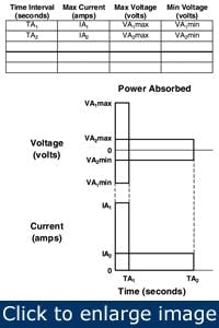

Power absorbed
When electric lift truck brakes are applied or forks are lowered, they can create regenerative energy. This energy must be absorbed by the energy source, and hydrogen fuel cells are not able to recapture energy like lead-acid batteries. Therefore, all hydrogen fuel cell units are actually hybrids and contain a lead-acid battery or supercapacitors. It is necessary to define how much regenerative energy each lift truck creates that needs to be absorbed by the battery or supercapacitors. As with power generated, lift truck manufacturers can specify the maximum and minimum current and voltage generated by the lift truck as it brakes from various speeds or lowers forks with different amounts of weight for different time durations. If the fuel cell is unable to absorb the energy generated, then a fault code would be generated that could potentially disable the lift truck. The ESS committee has developed a chart that can be used to specify power absorbed (see Figure 4).
