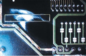

Figure 2. Moisture caused corrosion.
In Figure 2 you can see what happens to a control board periodically subjected to a moist environment. Initially, this VFD was wall-mounted in a clean, dry area of a mechanical room. However, as is often the case, a well-meaning modification led to problems. An area of the building, close to the mechanical room, required a dehumidifier. Wall space was available above the VFD, so the dehumidifier was placed there. Unfortunately, the VFD was a NEMA 1 enclosure style (side vents with no seal around the cover). Water began dripping from the dehumidifier and into the drive. In six months, the VFD accumulated enough water to produce circuit board corrosion.
