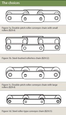

Two standard conveyor chain types are considered here. Both have straight-edged link plates, or sidebars. One type has small diameter rollers, or no rollers and the link plate edges of these chains slide on ways or guides when they are operating. OK, not all conveyor chains roll, but they’re an important part of conveyor chain usage. The chains that slide conform to American National Standards ASME B29.4 (Figure 1a) or B29.12 (Figure 1b).
The second type has rollers that are larger in diameter than the height of the link plates or sidebars, and the rollers of these chains roll on ways or guides when they are operating. These conveyor chains conform to American National Standards ASME B29.4 (Figure 1c) or B29.15 (Figure 1d). The pitch on ASME B29.4 chains ranges from 1.0 in. to 4.0 in. The pitch on ASME B29.12 chains ranges from 2.609 in. to 7.0 in. And the pitch of ASME B29.15 chains is from 3.0 in. to 6.0 in. Minimum tensile strengths range from 3,125 lb. for the C2040 chain in B29.4 to 155,000 lb. for the S864 chain in B29.12. Chain manufacturers offer many non-standard variants, but they work very much like the standard chains in service.

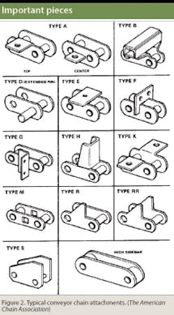

Many types of attachments are available for these chains (Figure 2). The user can then mount a variety of carriers on the attachments. As a result, these standard conveyor chains serve a large number of material-handling needs. And because they’re standard chains, their cost is usually lower than a special made-to-order chain.
