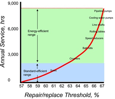

Figure 2
Above is an empirical chart for choosing a new repair/replace threshold. For relatively low operational hours, the curve is relatively flat, but as hours increase above 3,000 per year, it rises exponentially.

What obliterates the old 57% threshold is the startling fact that today’s rewound motor can be more efficient than it was when new. This isn’t always true, but where it occurs, the gain is, typically, a fraction of a percent. There’s enough history with the new rewind technology to prove that this trend is a fact, not a one-off fluke. An EASA/AEMT study put it this way: “…good practice repair methods maintain efficiency to within the range of accuracy that is possible to measure using standard industry test procedures (±0.2%) and may sometimes improve it.” This is true for both energy-efficient and standard motors.
New rewind technology won’t improve a standard motor to the point it can compete with an energy-efficient motor, but it makes rewinds of both types more attractive, particularly if new core plate is included. For energy-efficient motors in relatively good shape - they failed for electrical reasons, not mechanical or thermal reasons - energy efficiency gains of 0.5% have been reported after rewinding. Standard motors sometimes fare even better; it’s possible to see as much as a 1.5% increase in efficiency after a rewind.
What the end user gets for the money is a motor that can improve the plant’s watts-management position. For this reason, today’s repair/replace threshold has shifted from 57% to the mid-60% (Figure 2).
