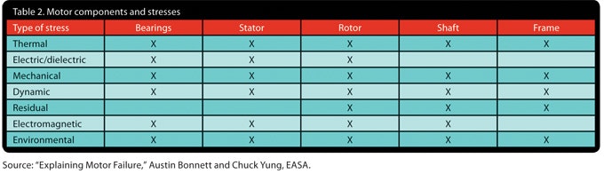

The motor is one part of a system that includes its power supply, mounting, coupling and driven equipment. The environment includes ambient temperature, airborne contamination in the vicinity (moisture, corrosive fumes), ambient shock and vibration, etc. It’s a combination of stresses acting on the bearings, stator, rotor, shaft and frame that causes most motor failures.
Motor stress

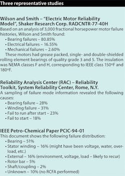

Table 2 shows the major stresses acting on the five primary motor components. A number of failure mechanisms can cause the same component to fail with a common mode and failure pattern. For example, improper voltage, overloading, blocked ventilation, excessive cycling and excessive heat all can produce the same type of winding failure. Many motor failure studies tell us that the bearings are the most common cause of failure. Next is electrical failure, followed by mechanical failure (see sidebar).
Table 2

Because bearing failure is the most common problem for electric motors, eliminating bearing problems can prevent 25% to 80% of motor failures.
