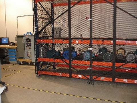

As shown in the graph, you can either test a few motors over a long time or test a large number of samples for a relatively short time; both situations being expensive. A compromise solution can be found through accelerating the testing with a reasonable number of samples. Statistical tools analyze the data to determine reliability. Fortunately, most of the failure patterns of electromechanical equipment can be represented by well-known distributions such as the normal (or Gaussian), exponential or Weibull. (The reliability information that results directly influences the OEM’s warranty policy.) A rig for testing motor systems for reliability is shown in Figure 2.
Fig. 2 Reliability testing rig is used for smaller motors.
These methods are practical only for single-phase motors and three-phase motors smaller than 5 hp, which, fortunately, reflect a large proportion of the industrial motor population. It’s estimated that about 60% of the U.S. integral horsepower motor population is rated between 1 hp and 5 hp and about 80% is rated between 1 hp and 20 hp. These tests aren’t feasible for larger motors. When these fail, they’re repaired using best repair practices, and motor build inspection analysis helps improve operational reliability.
