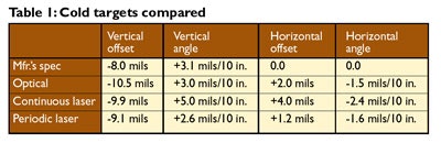

Table 1 compares the various measurement methods to each other and to the manufacturer's recommended cold alignment target.
Differences recorded generally fall within the tolerance range for this category of equipment with the exception of the manufacturer's horizontal alignment targets. Notwithstanding this exception, it was determined that adherence to the manufacturer's alignment targets should not have been sufficient to cause the experienced level of premature bearing failures.
