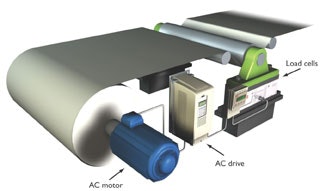

Figure 1. An integrated web speed and tension control that includes motor (left), drive (center) and load cell (right) applies easily to printing, coating, film, foil, flexographic, wire and cabling, and textile machines.

The unit was retrofitted with a five-horsepower AC four-pole motor, 4:1 gear reducer and a drive featuring built-in flux braking, which measures the motor torque and flux. The drive's clock rate of 40 kilohertz eliminates the need for tachometer feedback. The drive operates in torque mode, rather than speed mode.
The brake has to provide a torque equal to the desired web tension multiplied by the instantaneous roll radius. A 4-20 mA signal controls the motor torque and tension at any speed, including a dead stop. And, because the control loop response time is less than five milliseconds, it maintains optimal tension from zero speed through rapid acceleration, to steady-state speed and back down through rapid deceleration to a stop. The motor changes torque direction seamlessly to help maintain tension even during fast acceleration. For threading the machine, the brake motor can be sped up to provide enough slack web material to feed into the rollers.
Stable tension control also improves product quality. The motor, drive and load cell can be used for film, foil, flexographic, wire, cable and textile machines as well as for printing and coating.
