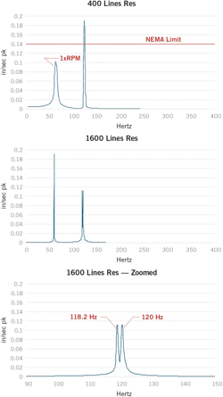

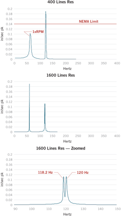

Beyond an initial assessment of machine condition, it often is necessary to take a more accurate look at specific frequencies in the spectrum. Expanding the display (zooming in) does not increase the resolution of a spectrum. More accurate determination of the frequency of a peak requires recording a new spectrum from the machine at a higher resolution. Both the fmax and the lines of resolution settings directly affect how accurately the frequency of a peak is indicated. Most spectrum analyzers have 3200 lines of resolution available; some have even more. High-resolution spectra are often used to separate 2x vibration on 2-pole induction motors, where 2xRPM and 2x line frequency (2xlf) are very close together. Figure 7 illustrates the effects of increasing the resolution and zooming the spectrum display.
A practical example illustrates the usefulness of high resolution for separating electrical vibration from mechanical vibration. A critical 2-pole motor was exhibiting high axial vibration at what initially appeared to be 2xRPM. Common diagnostic charts and references suggested the likely cause was shaft misalignment. But a subsequent high-resolution (3200 line) recording of the spectrum found the peak actually occurred at 2xlf, an electrical source. Further testing identified a resonant condition in the motor end bracket at the 2xlf (7200 CPM) frequency. Had the initial diagnosis of shaft misalignment been accepted, much time and effort would have been wasted trying to correct a non-existent mechanical problem.
