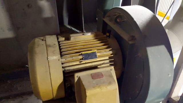

Next-level monitoring puts that type of comprehensive solution into the palm of your hand (or directly to your phone/tablet or computer). Several standalone predictive maintenance service companies or distributors can serve as your “data warehouse” by reviewing and interpreting all of that single-source raw data for you. To illustrate how this would work, let’s consider another critical motor application, but on a smaller motor (25 hp) that would typically not be rebuilt.
This 25 hp motor runs a critical combustion fan, and vibration and temperature sensors were recently installed to monitor asset condition. Data are reported to a dashboard several times daily with monitoring provided remotely. The vibration analyst identifies on a Wednesday that the motor bearings are in third-stage failure due to fan imbalance. This issue is identified early enough that you can refer to your distributor’s dashboard. From there, you can order a replacement to arrive the next day. You are shutting down the plant on Friday, and the motor will be staged and ready to replace. While the plant is down, you will open, inspect and clean the fan blades at the analyst’s recommendation.
On Friday, everything goes according to plan with the outage, and you start up the combustion fan and tell the analyst about the work performed. They can go into the dashboard, look at the data and confirm that the new motor is running smoothly, and that the fan imbalance is negligible after cleaning (see Figures 2-4).
