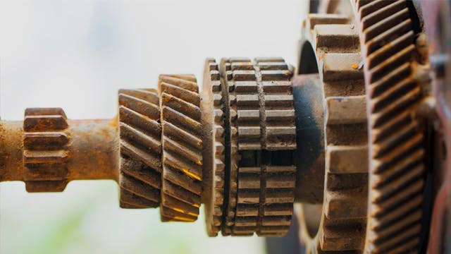

Extended exposure to moisture and humidity is the primary cause of corrosion in actuators (Figure 1). The in-out motion of the actuator shaft creates a negative internal pressure, which may require some kind of pressure relief function to prevent ingestion of moisture. The reaction to the metal surfaces and the water, facilitated by oxygen in the air, corrodes the metal. Actuators used in marine or coastal environments are even more susceptible to corrosion because the salt interacts with the metals.
