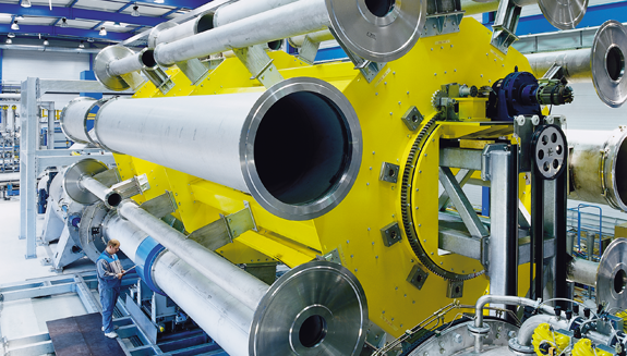

This portable flowmeter calibration rig can be brought onsite to compare flowmeter performance against a standards-traceable reference meter, avoiding the delays and potential damage inherent in transporting the meter to a laboratory.

These mobile rigs (see photo) compare a flowmeter’s performance against another reference meter with traceability. But for those applications requiring even higher accuracy, or to address especially large meter sizes, one’s choices are limited to dedicated calibration facilities such as Endress+Hauser’s regional calibration centers in Europe, Asia and North America, where a new Gulf Coast campus will open later this year. These dedicated facilities offer traceable, highest-accuracy calibration of even high flow-rate flowmeters.
