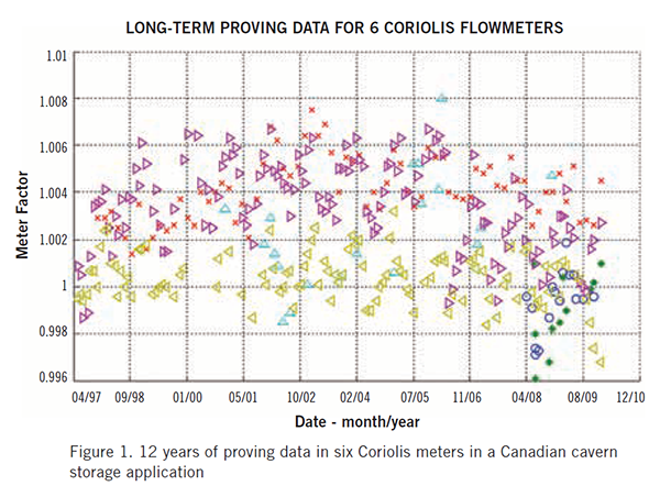

Coriolis devices can also measure density, because the period of oscillation of the flow tubes, at its resonant frequency, is related to the density of the fluid in the flow tubes. The mass and density measurements enable the calculation of the volume flow, with all measurements tending to be highly stable over time. Meter performance is also enhanced, because there are no mechanical moving parts that will wear or fail, and no straight pipe runs are required for flow conditioning. Figure 1 shows 12 years of proving data from six Coriolis meters in a cavern storage application in Canada. What becomes immediately clear is that meter factors are very stable.
