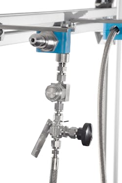

The source inlet (Figure 2) connects the high-pressure gas source to the gas distribution system. It must be designed with appropriate components, such as cylinder connections, hoses, tubing, filters, and functions for venting, purging, and pressure relief. Not all gas panels include a standard source inlet, so it is essential to verify the components and ensure that the correct cylinder connector is being used. Additionally, certain high-pressure or hazardous gases can require specialized component selection and additional design considerations.

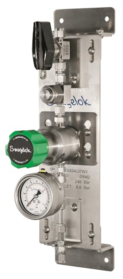

The primary gas pressure control panel (Figure 3) is responsible for the initial pressure reduction, ensuring the source gas is delivered at the correct flow rate to the next stage of the system. This pressure reduction can be achieved using either a single pressure regulator or a dual pressure regulator setup. Determining the correct inlet and delivery pressures can be complex, as different gases require different settings. For example, ammonia is typically bottled around 116 psi (8 bar), while nitrogen can be bottled at pressures as high as 4351 psi (300 bar). In some cases, bottles that traditionally use a two-stage pressure regulator may not require one, presenting a cost-savings opportunity.

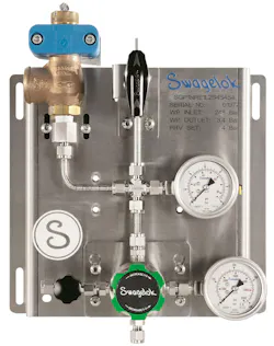

The automatic changeover panel (Figure 4) ensures an uninterrupted supply by seamlessly switching from one gas source to another. This process is managed through staggered set points on two pressure regulators, allowing the system to continue operating while the primary gas source is changed. Leveraging an automatic changeover panel can minimize waste by extracting as much as possible from each cylinder. Automating the changeover process eliminates the need for manual intervention, saving labor costs and reducing operational risks.
