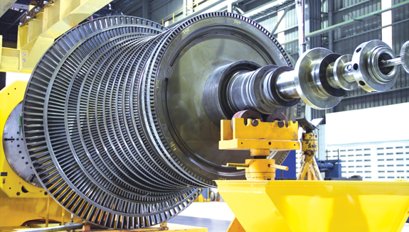

A steam turbine driver converts the thermal energy of steam into useful mechanical work to drive the equipment and machineries. Steam turbines can deliver constant or variable speed and are capable of close speed control. They serve as the drivers for pumps, compressors, fans, blowers, and many more.
Steam turbines have always been important parts of plants. As an indication, steam has supplied power to about 20-25% of all pumps, compressors, and machineries that moves fluids in plants.
Steam turbines are classified by mechanical arrangement, as single-casing, cross-compound (more than one shaft side by side), or multi-casing (tandem-compound), which is two or more casings in a single train. Steam turbines are also identified by steam flow direction, which is axial for most but radial for a few. Steam turbines can be categorized by steam cycle, whether condensing, non-condensing, automatic extraction, or reheat type.
In a steam turbine, the steam flow proceeds through directing devices and impinges on curved blades mounted along the periphery of the rotor. By exerting a force on the blades, the steam flow causes the steam turbine rotor to rotate.
The steam turbines proved to be very convenient drivers. They can be configured to operable at the speeds of driven equipment. They are more compact, lighter, better balanced, and more economical than the other drivers, such as reciprocating engines, gas turbines, or electric motor. Steam turbines has been substantially developed because of extensive use in the last 100 years. The efficiency has been significantly improved; output capacity has also been increased; and specialized steam turbines were provided for various driver applications.
This article discusses steam turbine drivers with the focus on operation, reliability, and maintenance.
Steam cycle and steam turbine driver
The cycle for the steam turbine driver consists of a heat source (boiler or heat recovery unit) that converts water to high pressure steam. In a steam cycle, water is first pumped to elevated pressure using boiler-feed water (BFW) pumps, which is medium to high pressure depending on the size of the unit and the temperature to which the steam is eventually heated. The steam is then heated to the boiling temperature and then most frequently superheated (heated to a temperature above that of boiling). The pressurized steam is expanded to lower pressure in a multistage steam turbine, then exhausted either to a condenser at vacuum conditions (condensing) or into an intermediate temperature steam distribution system (non-condensing) that delivers the steam to other applications. The condensate from the condenser or from the industrial steam utilization system is returned to the BFW pumps for continuation of the cycle.
The steam turbine driver itself usually consists of a stationary set of blades (called nozzles) and a moving set of adjacent blades (called buckets or rotor blades) installed within a casing. The two sets of blades work together such that the steam turns the shaft of the turbine driver and the connected driven equipment. The combination of torque and speed is the output power of the steam turbine driver.
