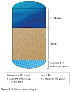

Ion exchange specification data can be used for calculating performance in general terms. Figure 9 and Table 1 include some useful formulas and mechanical information that can help compare field results with actual operation of the ion exchange equipment.
For determining resin volume in cubic feet, take an actual measurement of the resin depth in the vessel and use the following formula shown in Figure 9. In lieu of physical measuring of the resin height and calculation, consult the softener manual for resin volume. The freeboard area should allow for a 50% expansion of the resin during backflush. The softener is not completely filled with resin.
Distributors for larger softeners will have a spider web design under the resin and covered with bed support material. Small water softeners may have a different distributor design.
