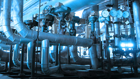

The routing of piping is heavily influenced by the stresses generated due to different loadings such as temperature differences, operating pressure, weight of components, dynamic loadings and others. Long piping operating under high temperature gradients tends to move significantly due to thermal movements, and this can potentially generate considerable stresses and even failures. Another key concern is the allowable nozzle loads of machineries and equipment.
It is important to guarantee safety against piping or connected equipment failure, as well as to protect anchor, support structures, and other parts from overstress. On the other hand, optimization is necessary and excessive factors or massively oversized systems or components have been discouraged. Therefore, accurate piping stress analysis is required for proper optimization.
This article offers practical notes and useful guidelines of piping stress analysis in optimization, revamp, renovation, expansion, and debottlenecking of plants. Some piping systems have been assessed as simple and just a simple check and review is needed for them. However, many piping systems need proper stress analysis.
Stress analysis should be undertaken for the following piping:
  1. Piping operating at low or high temperatures or extreme conditions. This includes piping that is subjected to extreme conditions only during special or alternative cases (such as de-pressurization or re-pressurization). This group also includes piping subjected to pressure relief or safety valve (PRV/PSV) loads, relatively large displacements, and those that are susceptible to flow-induced vibration and other extreme situations.
  2. Relatively medium and large sized piping. These pipes need stress analysis because the piping has inherently low flexibility, and even small deformation (such as a small thermal movement) is associated with high stresses. As a very rough indication, 4-inch (DN100) pipe could be the limit. Many 3-inch (DN80) pipes might need stress analysis due to their configuration or operating conditions.
  3. Piping connected to equipment and machineries. These pipes nearly always need stress analysis as nozzle loads should be compared with allowable values.
  4. Piping subject to transition. For example, those at transition from above-ground piping to underground piping.
