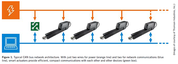

Smart actuators help OEM designers build smarter machines, thanks in part to the benefits realized by using integrated bus technology (see Figure 1). Engineers can control the speed, position, and current trip point of axes while receiving critical diagnostic data that can be used to optimize each device’s performance. The system will monitor the status of each device and share the information with machine operators, maintenance personnel, production managers, and even other devices within the machine process. Programming operations, collecting data and engaging in condition monitoring in real time is what makes a factory smart.
