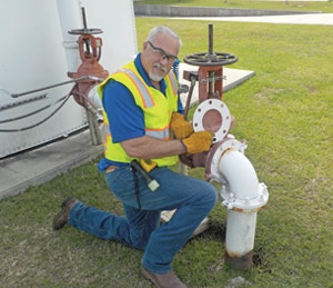

For example, in the image at right, the 6” 150# flange in water service had been leaking since the first gasket was installed, and rust stains showed the leak area and leak path. Because the leaking was isolated to one bolt area at the top, it appeared that one bolt was not tightened to the proper torque on installation, and the leak continued to get worse. The solution was to shut down the system, lock all involved out of the system for safety, and remove the old gasket. The next step was to clean the sealing surfaces, use new bolts, nuts, and HX washers of grade B7 or above, and lubricate only the bolts, nuts and washers. (And follow the manufacturer’s suggested installation procedures.)
