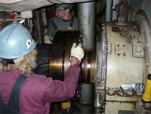

Figure 1. Your MRO team needs to standardize how they execute maintenance across your facilities.
In an attempt to better ascertain the results of an expensive RCM implementation, management decides your MRO team needs to standardize how they execute maintenance across your facilities (Figure 1). This need translates itself into another project from corporate, and, as all projects go, this one is no different in manpower requirements to implement it fully. Your management team decides that some sort of standardized maintenance management system or work management process is long overdue since it’s difficult to measure results with scattered, unconnected data. And, if results cannot be measured, then they can’t be managed, and, if they can’t be managed, then by the same reasoning, long-awaited improvements to your process can’t be realized. And if your process doesn’t improve, all the work and money that has been invested into your organization yields questionable returns, at best. This scenario is not a wise use of your company’s resources thus far. So, what needs to happen next?
