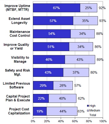

Figure 2. Improved uptime topped the list of survey participants’ EAM application drivers.
The chart contains the high and medium responses to visually emphasize the key drivers (Figure 2). The benefits of an EAM system read like “getting back to basics” with the five goals of uptime, asset longevity, cost control, quality, and safety. They directly affect C-suite metrics in the P&L statement, balance sheet, and annual report with regard to revenue, cash conservation, profitability, and risk management (Table 1).
