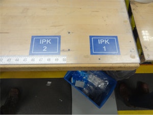

Another example of visual flow can be seen on the production line itself, where products are produced in continuous flow. Between workstations on the line, there are a fixed number of places where work in process (WIP) can physically be placed (Figure 2).
Figure 2. Only two spaces where work in process can be placed between workstations on this continuous flow production line: IPK1 or IPK2 (IPK stands for in-process kanban).
If more work is present than is permitted by the rules of flow, or if the associates see that more work is about to be present, then each associate knows what to do to get the flow back on track, whether by temporarily halting production and cleaning the workstation, engaging in supplemental 5S activities, or even moving up or down the production line to assist another associate with the issue causing the backup.
Again, all of this takes place without the need to ask a supervisor or manager because the standard work for correcting abnormal flow has been pre-established and agreed upon. In Figure 3, there is an even more robust example of what to do when flow breaks down, where the production associates are instructed on what to do if the WIP exceeds one hundred pieces.
