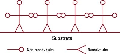

The reactive sites on the molecule (see Figure 2) results in a family of non-stick, self-bonding polymers that can be applied in a few seconds with a simple wipe or by brushing. This means, for example, that presser bars no longer need to be sent for re-coating. When rubbed into a monomolecular layer and polished, polymers produce a slippery, protective, easy-to-clean surface on metals, plastics, wood, fiberglass and fabrics.
Resistant to most acids, bases and detergents, SBPs produce a finish that reduces surface friction. Its lubricity can benefit many manufacturing processes, including reducing the power needed to drive conveyors and providing a non-stick finish for packaging and processing equipment.
Figure 2. Monolayer polymers require some number of reactive sites to make them adhere to solid surfaces.
