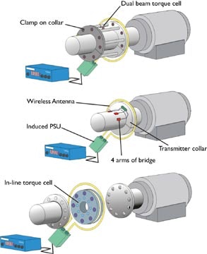

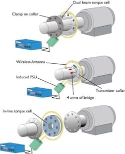

Figure 2 shows typical wireless measurement schemes.
Figure 2. Wireless torque monitoring systems, including clamp-on collar, strain-gaged shaft and inline torque cell.
In-line wireless torque cells
Wireless torque cells consist of a rotary torque transformer connected in-line with standard industry flanges, coupled to the stationary portion of the assembly by wireless transmission. It includes a stationary loop antenna that induces power into an embedded antenna on the rotating torque cell, which supplies the excitation voltage to the strain gages and power to the radio transmitter mounted in the torque sensor. The radio transmitter modulates the strain signal for transmission to a stationary antenna. In-line torque cells offer high torsional stiffness to maintain system dynamics. They are pre-calibrated, and most have an internal calibration system that supplies a calibrated output signal to adjust instrument span in the absence of a known static torque. The wireless telemetry feature eliminates support bearings and their maintenance. In-line torque systems require cutting the shaft or lengthening the machine train to accommodate the inserted in-line transducer.

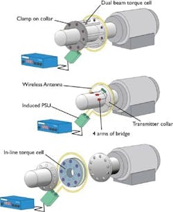

Clamp-on torque cells
A clamp-on torque cell works on the wireless telemetry principle with the inherent advantages of a non-contact system. It's immune to oil and dirt, but has the advantage of not requiring the rotating shaft to be cut. The clamp-on torque cell is a pre-calibrated bending beam mounted between two collars that clamp on the shaft (see Figure 3). Accurately spaced knife-edges provide an accurate, reliable shaft torque measurement without marring or modifying the shaft. The clamp-on feature allows the torque measuring system to be moved to other similar installations easily in less than 30 minutes. This means the unit is ideal when torque or horsepower monitoring forms part of the final check-out of multiple machines. It handles shaft diameters from 3 to 32 in. and as much as 100,000 hp.
Figure 3. Clamp-on torque cell
