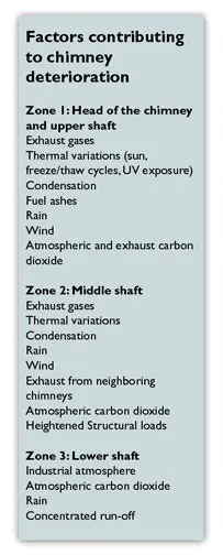

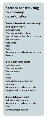

To better understand the factors that cause deterioration, divide the chimney into three sections or zones. Each zone is subject to common deterioration factors, as well as some that are unique to it.

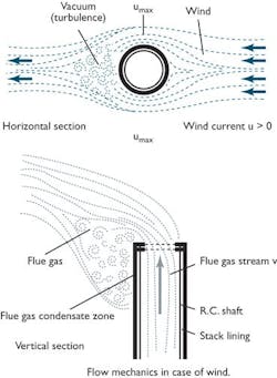

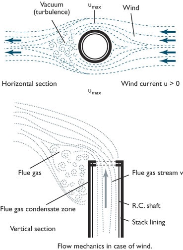

When wind velocity is greater than zero, an airflow pattern develops around the stack quickly. Figure 1 shows the effects of a positive wind velocity. Aerodynamic volume displacement increases wind velocity around the stack. This produces a zone of negative pressure on the leeward side, and draws in the flue gas. Because the shaft surface temperature is much lower than that of the emerging flue gas, condensation occurs on the leeward side, leaving yellow, brown or black deposits.

The effects of wind on chimney deterioration can be significant. A zone of negative pressure develops on the leeward side of the stack, causing wind turbulence. Flue gas,containing potentially corrosive compounds,is then drawn in to this area.
Illustration courtesy of Robert Engelfried, University of Dortmund, Germany.
