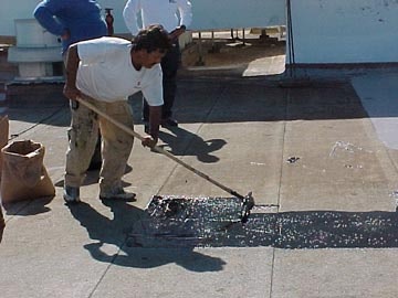

Always apply coating evenly with a flat squeegee.

Restoration coating selection is based on the type of existing surfacing and the preferred application method. A coal tar pitch built-up gravel surface roof, for example, can be restored using either a cold or hot method. The cold process method typically uses a solvent-borne coal tar resaturant. The unique penetrating qualities of solvent-borne resaturant improve flexibility and add new life to an aging system.
Restoring coal tar roofs
After the preparation, membrane replacement and flashing repairs, verify that the surface is dry. Apply the solvent-borne coal tar resaturant evenly at a rate of seven gallons per 100 sq. ft. Apply the new roofing aggregate immediately at a sufficient rate to cover the coating completely.
If the hot coal tar is preferred, heat it to the manufacturer's recommendation. Apply an even top pour at a rate of 85 pounds per 100 square feet. While the coal tar pitch is still molten, apply immediately a uniform layer of new roofing aggregate at the rate of 400 pounds per 100 sq. ft.
