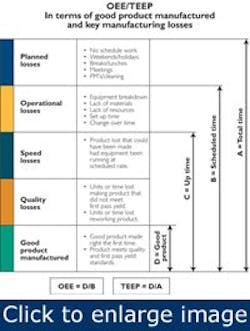

Several reliability measures and calculations are available. Two of the most useful are overall equipment effectiveness (OEE) and total effective equipment performance (TEEP). They are calculated as follows:
View more asset management content on PlantServices.com
OEE = good product/(operational losses+speed losses+quality losses).
TEEP = good product/(operational losses+speed losses+quality losses+planned losses).
OEE and TEEP can be calculated easily and applied to critical manufacturing equipment. These measures determine the reliability levels of equipment and systems.
Measuring and charting OEE and TEEP presents a clear picture of where losses are located (Figure 1). This helps determine the most economically worthwhile areas to apply reliability-centered maintenance (RCM) and root cause analysis (RCA).

Overall equipment effectiveness (OEE). Total effective equipment performance (TEEP)
