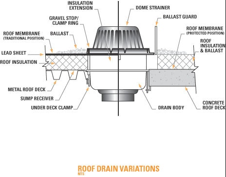

Internal drainage systems — roof drains
Roof drains with interior rainwater piping are  often the highest cost method for draining roofs. However, it offers the greatest flexibility in roofing design. Roof slopes can be developed as needed and drains are installed at low points and sized to suit the drainage area and rainfall rate. Roof drains are installed as an integral part of the roofing assembly and must be compatible with roof structure, insulation and waterproofing membranes. Many commercially available roof drains meet these requirements and are standard products with standard options. Because of the standardized nature of these products, many contractors, and some design professionals, sometimes overlook the details of the drain and roof assembly. This often leads to premature failure (leaks) and unhappy owners.
Here are some key details to remember when designing a roof drainage system.
On corrugated metal decks, a sump receiver plate should always be used to distribute the weight of the drain uniformly.
Unless cast into a concrete deck, roof drains should have underdeck clamps. This secures the drain body to the structure, making it integral to the roof structure. Without this clamp, the drain body will move independently from the roof assembly, causing stress at the interface with the roofing membrane.
Appropriate extensions should be provided if the insulation is located on the top of the roof deck. Often, insulation is shaved or tapered in an attempt to avoid an insulation extension. However, this is not recommended by either drain or roofing system manufacturers.
[pullquote]
The joint between the roofing membrane and the drain body is critical. It’s made by fastening the gravel guard to the drain body and clamping the roof membrane between the two pieces. To provide support for the membrane, most engineers will specify a lead sheet to extend 12 to 18 in. from the clamp ring and below the roofing material. This small detail can greatly improve the junction’s effective life.
Strainers are required by code and should typically be the dome type. They should be secured to the drain to prevent being blown away (or otherwise removed). The size of roof ballast also should be coordinated. If too small, it passes through the dome strainer, leading to possible stoppage problems.
Drain piping should allow for movement. The temperature differentials produced when cold rain hits a warm building cause considerable movement in the piping system. Elbow offsets usually compensate for this movement; however, if the drain piping runs straight down from the drain connection to a fixed point, an expansion joint probably will be necessary.
Horizontal rainwater piping in humid, heated areas should be insulated to prevent condensation and potential water damage. The same holds true for the underside of the drain body.
Secondary drainage, such as scupper or secondary roof drains, will be required. Secondary roof drains are similar to primary drains except they have wiers or standpipes that elevate the inlet above the level of the primary drains. Secondary drainage piping must be separated from primary piping and must discharge at an observable above grade location.
Materials for roof drains are usually cast iron or plastic, but may be cast bronze or even stainless steel. Common piping materials include PVC, cast and ductile iron, and galvanized steel.
Piped roof-drainage systems require additional coordination and attention to details for proper installation. However, they allow great flexibility in roofing design, are pre-engineered to allow for easy installation and repeatability, and are reusable when the roofing material must be repaired or replaced.
