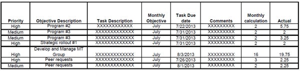

  • The time-motion spreadsheet has two main tabs. The first is the data entry tab, in which the individual activity hours are recorded (Figure 1). The second is the monthly priorities tab, in which the monthly plan is developed (Figure 2).
Figure 1. In the data entry tab, the individual activity hours are recorded.
Figure 2. In the monthly priorities tab, the monthly plan is developed.
  • Individual tasks on the monthly priorities tab (task descriptions) are categorized under the various activities and objectives shown on the data entry tab. In this way they can be linked and rolled up into the time-motion study.
  • As you think of tasks which need to be completed in a future month, insert a line on the monthly priorities tab along with time estimates and notes so planning the next month’s objectives becomes easy.
