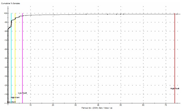

Figures 2 and 3 compare cumulative distribution plots for the ferrous-index data presented in tables 1 and 2 obtained from the samples of in-service turbine oils and coal pulverizer gearbox oils. The ferrous index is a measure of freshly generated iron wear debris, which is typically due to abrasion, adhesion, or fatigue wear mechanisms. You will see that 80% of the turbine oil samples and 35% of the pulverizer gearbox oil samples show a ferrous index of zero with the numbers escalating from that point. For turbine oils, the 90th percentile corresponds to a ferrous index of 2, the 95th percentile is 3, 97th percentile is 6 and the 99th percentile is 73. For pulverizer oils, the 90th percentile corresponds to ferrous index of 20, the 95th percentile to 45, 97th percentile to 95, and the 99th percentile to 320. Depending on the application, such threshold percentiles can be used to evaluate alarm-limit settings corresponding directly to low alert, high alert, low fault, and high fault, respectively.
Figure 2. Eighty percent of the turbine oil samples show a ferrous index of zero with the numbers escalating from that point.
